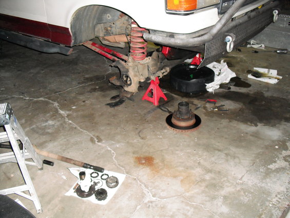

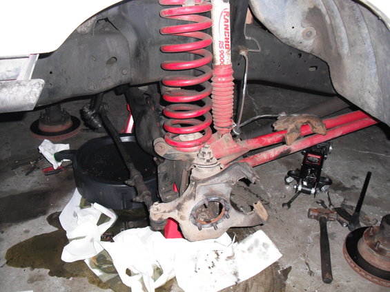

I'm sending it out to be put together but at least I got it all apart. I called Dave with a problem I had getting the axle shaft out. Turns out the steering has to be pretty damn straight to get the shaft out. Here's some pics.
Looks like someone has been in the pumpkin before. I don't think the orange is a factory gasket.

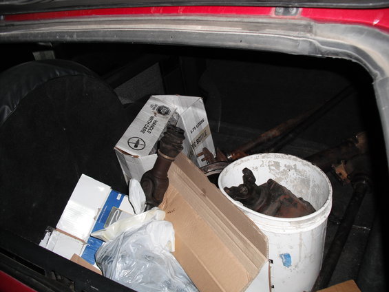

One full blazer packed going to Marks place. It has my nine inch in it as well so he can set-up the gears and stuff for that as well.
